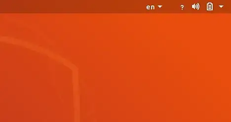

I installed Ubuntu 18.04 right now and after connecting to the internet instead of a network icon there is a question mark. There is no network issues, but that question mark is annoying.
Image of Ubuntu 18.04 question mark icon in place of wifi icon

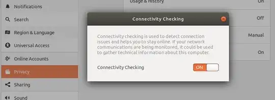

Settings > Privacy > Connectivity Checking
screenshot
Set it OFF. (Then, restart your WiFi connection, thanks to @Dante's comment below).
This is the same fiasco as Microsoft's NCSI (Network Connectivity Status Indicator), a false negative to try ruin your mood.
And, yeah, it would be checking some URL like that one.

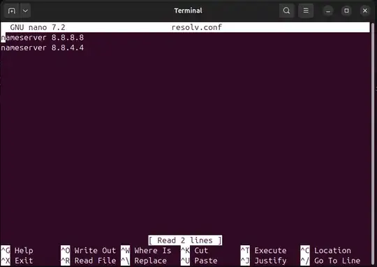

I solved it by adding a line to resolv.conf.
cd /etc/
sudo nano resolv.conf
and then just adding the two Google nameservers:
nameserver 8.8.8.8
nameserver 8.8.4.4
Nano editor editing resolv.conf:
Image of Nano editor editing resolv.conf
