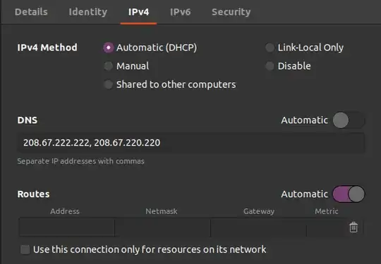

I used the graphical network manager to change my DNS server to the OpenDNS address.
Everything works fine but the WiFi signal icon has changed to question mark.
