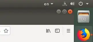

My network icon is always a question mark in both wired and wireless connection but everything network related works correctly.
icon is a question mark like you can see in screen shot

I had same issue. Googled for answer and found that if you edit /etc/NetworkManager/NetworkManager.conf and insert the line
dns=default
to the [main] section and the question mark over the lan icon disappears.
