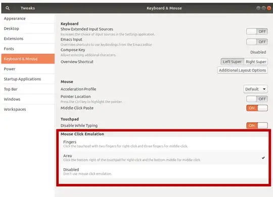

Another option (thanks OP) is to install gnome-tweak-tool (either through your software manager or through sudo apt install gnome-tweak-tool in the terminal). Navigate to the “Keyboard & Mouse” sub-menu in the left menu of gnome-tweak-tool, and select “Areas” from the touchpad’s “Mouse Click Emulation” options in the right side panel, as shown in the red box in the image below: Relevant setting in gnome-tweak highlighted
[Warning: This fix is for the libinput driver that ships as the default input driver for Ubuntu 18.04. YMMV if you've installed the (different) synaptics driver before trying this fix.]
