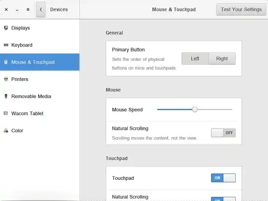

I also encountered the same problem after upgrading from 16.04 to 18.04. I figured out that there was something wrong with settings.
Mouse & Touchpad settings
Just change primary button to left.
