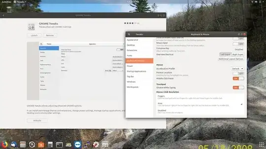

I too had this issue with an HP Omen.. I downloaded the gnome tweaks and it fixed the problem.
Open Ubuntu software (orange briefcase) and type in the search "gnome tweaks".. launch the program and under keyboard and mouse tab>Mouse click emulation> choose AREA..click bottom right.....
Log out and re-login if the change didn't take effect right away.
screen shot
