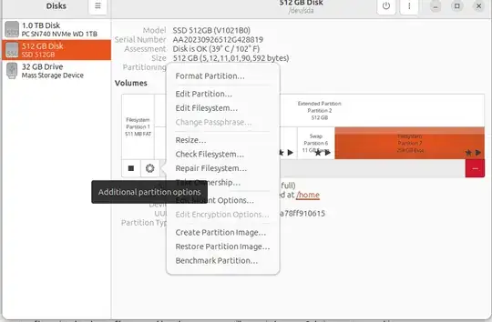

My home partition is separate from the root partition. I had the same problem that gnome disks reported that insufficient space was available to create an image even after deleting the files. It was then that I observed that system files existed and even files opened by other programs still occupied space. The solution was to reset ownership rights of the folders.
Use the option take ownership
Now I regained space and I no longer had the error.
