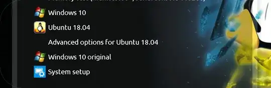

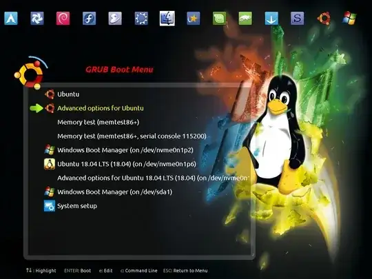

Before and After
The images are a little skewed because I'm limited to capturing them at distorted 1600x1200 in Virtualbox in Ubuntu 16.04:
Before
Before
After
