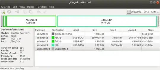

  • Create a gpt partition table on a USB stick.
  • Create partitions as shown above, select unformatted for partition 2.

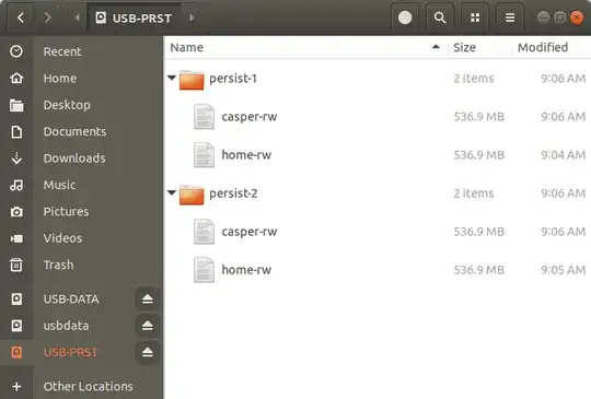

  • Create an uniquely name folder for each OS, (that requires persistence), on the USB-PRST partition.
  • Add a casper-rw file, (and optional home-rw file), to each persistence folder. A home-rw file can be made by renaming a casper-rw file. A home-rw file is like a separate home partition on a Full install, it can be reused after version upgrades.

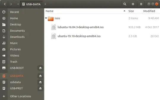

  • Create a folder for the ISO files on the NTFS USB-DATA partition.
  • Add some ISO's to the isos folder.

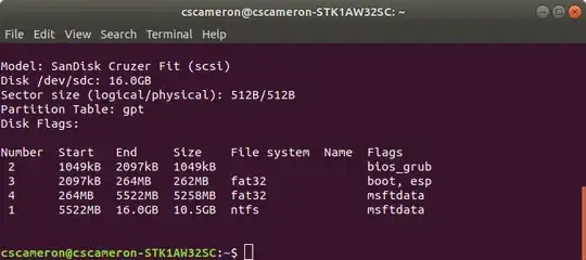

sudo parted -ls  /dev/sdx

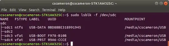

sudo lsblk -f  /dev/sdx
