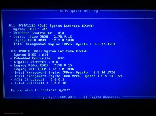

You do not need Windows to install any firmware updates from their site, just follow the instructions posted here.
From the Dell website:
  1. Download the WIndows/DOS BIOS installer for your hardware from dell.com
  2. Download the latest SystemRescueCD and burn it to a blank CD or install it to a USB flash drive.
  3. Copy the Windows/DOS BIOS installer to a FAT formatted USB stick or the one that you installed the SystemRescueCD on.
  4. Boot from the CD or flash drive.
  5. Choose to boot from FreeDOS in the floppy images menu.
  6. Make sure you do NOT load HIMEM and EMM386 memory managers.
  7. Change to the USB stick (typically C: if you do not have any FAT partitions on your HDD).
  8. Run the installer
Example when running the A14 update for the E7240 machine.

  8. Load the CD into the machine. Reboot, F12, boot from CD and run the BIOS .exe.
On newer machines, post 2015 I believe, you can simply put the .exe updater (even though the official description only mentions Windows) in /boot/efi/, reboot, press F12 and select Flash BIOS upgrade. I did this with the XPS 15 9950 and it worked like a charm. Also see BIOS update dell.

Have you seen the DellBIOS - Ubuntu Wiki article?? It seems to be quite thorough and answers your question on how.
These instructions from Dell worked perfectly for me after a couple of previous unsuccessful tries.
http://www.dell.com/support/article/us/en/19/SLN171755/en
Comprised of:
  • USB stick
  • FreeDOS Base ISO 1.0
  • UNetbootin
Updated my Dell Latitude E6420 easily from BIOS version A07 to A08 to A23 (A08 was required before I could flash in one go up to A23).
Simple and fast.
