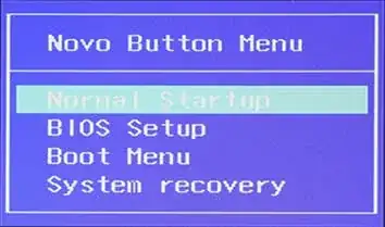

The issue repeated the second time already today and I restarted it again. This menu showed up: The menu
This seems to have something to do with my laptop and could be a part of it's ROM, I guess. However, IDK what exactly it is, why the keyboard stops working and all of this happens. I guess one solution would be to completely reinstall my operating system?
