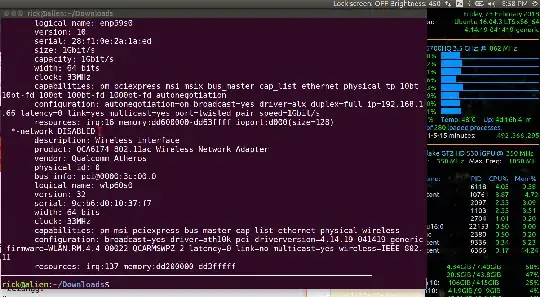

The command output of: sudo lshw -class network shows your network Wifi card as "disabled". In the animation below the same model of card is initially shown as disabled. Then from the system tray menu the Network icon is clicked. From the drop down menu the "Enable WiFi" option is clicked on. Then lshw is run again and the Wifi card is no longer disabled:
I suggest that you try upgrading the firmware. From the terminal:
cd /tmp
wget http://mirrors.kernel.org/ubuntu/pool/main/l/linux-firmware/linux-firmware_1.169.2_all.deb
sudo dpkg -i linux*.deb
Reboot and your wireless should be working.
