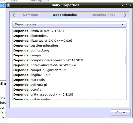

This compiz update forced removal of unity and ubuntu-desktop on my 16.04 Ubuntu system.
The offending package that is missing, but unity needs, seems to be compiz-core-abiversion-20151010. It seems to be a virtual package, and I can't find it to download.
As it happens, I mostly use LXDE on this system, but I'd be very unhappy if I used Unity...
Since I do occasionally use the Unity desktop, is there a fix for this?

Very strange situation.
Yes compiz-core-abiversion-20151010 is virtual on xenial and zesty, but it is provided by compiz-core:
$ apt-cache show compiz-core  | grep "Version\|Provides\|Package"
Package: compiz-core
Version: 1:0.9.12.3+16.04.20180221-0ubuntu1
Provides: compiz-core-abiversion-20180221
Version: 1:0.9.12.2+16.04.20160415-0ubuntu1
Provides: compiz-core-abiversion-20151010
So APT and dpkg knows about both of them.

Here as we know compiz-core-abiversion-20151010 is not installable:
$ sudo apt-get install compiz-core-abiversion-20151010
Reading package lists... Done
Building dependency tree
Package compiz-core-abiversion-20151010 is a virtual package provided by:
  compiz-core 1:0.9.12.2+16.04.20160415-0ubuntu1 [Not candidate version]
E: Package 'compiz-core-abiversion-20151010' has no installation candidate
