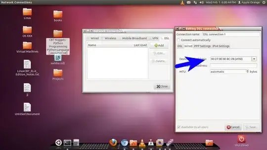

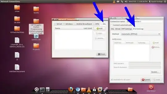

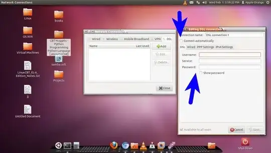

The Click On Edit Connection > DSL > ADD enter image description here enter image description here enter image description here

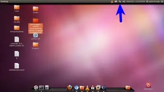

Actually in my case it was still simpler : Right-click the network icon on the menu bar, click "Edit Connections", in the dialogue box that comes up click the "Add" tab, which will lead to another dialogue box, click open the low-down, choose "DSL", click "Create". In the next dialogue box type in your User Name, Service Name and your Password and click "Save". Go back to the network icon on the menu bar and click "DSL connection". Done.
