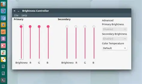

If you are using a desktop, you can use Brightness Controller, which is a GUI tool to control brightness, and it can also change the color temperature (it uses xrandr in the backend)
sudo add-apt-repository ppa:apandada1/brightness-controller
sudo apt update
sudo apt install brightness-controller
(disclaimer - I am one of the developers of this software)
You will have to disable Night Color to use Brightness Controller (note that it does not work with Wayland).
