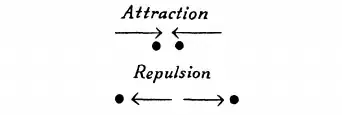

Law of conservation of momentum is directly implied by Newton's laws of motion. Basically it is conserved even in inelastic collision because forces appear in pairs with equal magnitude and opposite direction as shown :
The two dark dots are two particles. The direction of arrows shows the direction of force and the length of the arrows shows their magnitude.
In all the physical phenomena the forces can be represented by the above mentioned image. For the inelastic collision this image also holds e.g. consider an inelastic collision as shown:

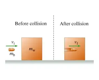

The block of mass $M$ is initially at rest and a bullet is moving towards it with a velocity $v_i$ and mass $m_w$. What happens during the collision? There appears a force pair of equal magnitude and in opposite direction. The force pair continuously varies in magnitude during the collision. The force pair is kinetic friction It continue to act until the relative velocity of bullet w.r.t the block becomes zero that is, both bullet and block acquires same velocity. These forces are represented as $\vec F_b$ and $\vec F_w$. $\vec F_b$ acts on the bullet towards left and $\vec F_w$ acts on block towards right.
By newton's third law $\vec F_w=-\vec F_b$
Change in momentum of bullet $= \Delta p_b = \int_{t_1}^{t_2}\vec F_b dt$
Change in momentum of the block$ = \Delta p_w = \int_{t_1}^{t_2}\vec F_w dt$ It is easy to recognize that since $\vec F_w=-\vec F_b$ the decrease in momentum of bullet appears as the increase in momentum of the block. Now the underlying fact is that if decrease in velocity of bullet causes a decrease in the momentum of bullet then at the same time the velocity of the block increases which causes the momentum of block to increase.
A different scenario can take place if the block is not stationary but is moving towards the bullet. Further let the initial momentum of the system is 0 what would happen after the collision? the bullet will sink in the block and the velocities of both block and bullet will become 0! That is, total kinetic energy of the system becomes 0!. We see K.E of the system may be changed (not the total energy) but momentum of the system cannot.

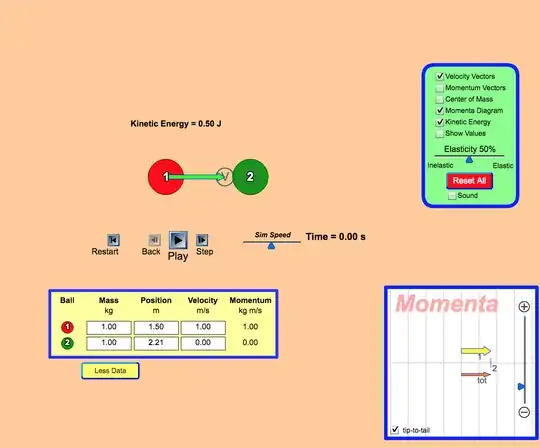

Consider the simple case of two 1kg balls in the PHET physics simulator.
This is a fascinating question. It would seem that if kinetic energy and momentum both depend on the same velocities they would both be conserved.
But the kinetic energy has a non linear dependence on velocity. This permits energy to be lost while the momentum remains conserved.
  • Conservation of momentum is a consequence of Newtons laws in a system isolated from external forces.
  • This example shows that it may not be to do with the scalar /vector argument mentioned above but instead as a result of the non linearity of the kinetic energy polynomial.
Ball 1 is moving to the right at 1 m/s
Ball 2 is at rest
Before the inelastic collision the energy of the system is $\color{blue}{0.5 \text{J} }$
$$\frac{1}{2}m v^2+\frac{1}{2}m v^2 = \frac{1}{2}(1) (1)^2+\frac{1}{2}(1) (0)^2$$
The total momentum of the system is $\color{red}{1\text{ kg m/s} }$ $$\frac{1}{2}m v^2+\frac{1}{2}m v^2 = (1) (1)+(1) (0)$$
After the inelastic collision the energy of the system is $\color{blue}{0.31 \text{J} }$ This is because Ball1 is now going at $\color{red}{0.25 \text{m/s}}$ and Ball2 is now going at $\color{red}{0.75 \text{m/s}}$
$$\frac{1}{2}m v^2+\frac{1}{2}m v^2 = \frac{1}{2}(1) (0.25)^2+\frac{1}{2}(1) (0.75)^2 = \color{blue}{0.31 }$$
But the total momentum of the system is still $\color{red}{1\text{ kg m/s} }$!!! $$\frac{1}{2}m v^2+\frac{1}{2}m v^2 = (1) (0.25)+(1) (0.75)= \color{red}{1}$$

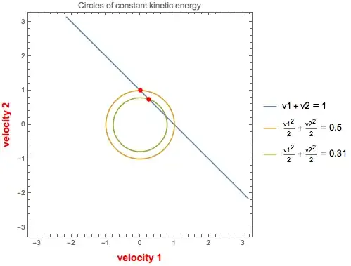

Conclusion
Even though the velocities change in the inelastic collision, the momentum still adds up to 1, but the energy square law cannot follow. Mathematics permits the system to have the same momentum but a different kinetic energy after the collision.
The blue line is a line of constant momentum of 1 kg m/s. The orange circle is a constant kinetic energy of 0.5. The green circle is a constant kinetic energy of 0.31. Even though both the initial velocities (red point) and the final velocities (black point) lie on the blue line and correspond to the same momentum, they can lie on different kinetic energy circles.
