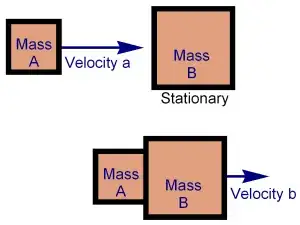

1) mass is not constant and velocity is different: in a completely inelastic collision the two objects (A: m =1, B m = 2) stick together and mass becomes A+B = M = 3
Suppose that $v_a = 6m/s$ and $v_b = 0 \rightarrow E_k = 0.5 * 6^2 = 18, p_a = 1 * 6 = 6, v_{cm} = p/M = 2$
After collision velocity would be anyway lower as KE should be distributed among more mass, but some KE is lost in the crash. How much?
Momentum is conserved: $ p_{ab} = 6$ , from this datum you can calculate its velocity: $$v_{ab} = v_{cm}= \frac{6}{3} = 2$$ and $E_k = 0.5 * 2^2 *3 = 6 \rightarrow E_a = 2 + E_b = 4$.
Some energy has been transferred to B, but two thirds of the energy have been lost.
Velocity of center of mass is the same, although KE has changed.
