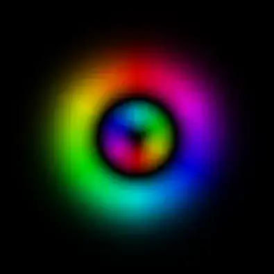

For example, here is a complex plot of the function $|\nu=3,l=1\rangle$ state:

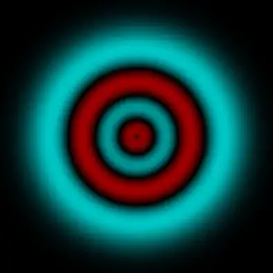

Here is a plot of the $|\nu=6,l=0\rangle$ state:

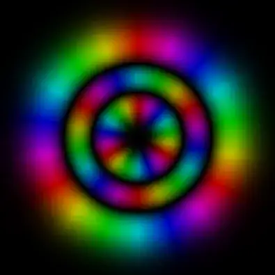

And here is a plot of the $|\nu=7,l=3\rangle$ state:
The plots are generated in a Hue colorspace, with the brightness proportional to amplitude, and color cyclically coded according to phase angle in the complex plane.
With the exception of zero vibrational angular momentum states, it is visually apparent that none of the wavefunctions can be represented as a real function multiplied by a phase factor $e^{i\alpha}$. Hopefully you find this sufficient as an example where a system has stationary states which are non-trivially complex-valued. I'm sure there are lots of other examples of cases where the time-independent Schrodinger equation has eigenbases which are nontrivially complex-valued, but this is the first example which came to mind.
