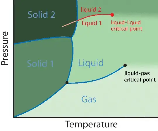

One example is the liquid-liquid transition exhibited by some model systems, in which a transition from a low density to an high density liquid state appears.
The presence of a liquid-liquid critical point has been hypothesized to explain some thermodynamic anomalies of liquid water. Unfortunately, it is extremely difficult to reach this critical point experimentally, because the system undergoes spontaneous crystallization.
But it has been found out in numerical studies of some simple model systems of water that a liquid-liquid critical point is indeed present, and two distinct, stable liquid phases appear: a low density and high density liquid.

Nothing in the laws of thermodynamics forbids multiple liquid phases for a single substance. The only limit is the simultaneous coexistence of at most three phases (at triple points).
Water has a solid-liquid-gas triple point and several solid-solid-liquid and solid-solid-solid triple points; see the phase diagram of water and ice. In addition, although not visible in this diagram (showing only stable phases), it is not true that water has only two fluid phases. Indeed, in the supercooled regime, there are two distinct liquid phases that may coexist under certain conditions. See

There is actually only one disordered phase - from a physicist's perspective, the liquid and the gas are actually the same phase because one can continuously vary the external parameters (temperature and pressure, in this case) to get from the liquid to the gas without passing through any phase transition, because the phase transition line terminates within the phase. (The "liquid-liquid" transition that valerio02 describes is another example of a phase transition within a single phase.) It may seem counterintuitive that you can have a phase transition with the same phase on both sides, but it's true.
