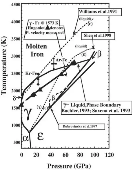

Iron, however, is much more complicated than many elements you may be used to. Sure, it can take on a variety of crystalline solid phases, as shown above, but we’re not interested in these normal pressures, shown in the diagram above. We’re going all the way down into the core of the Earth, where the pressure is millions of times what it is at sea level.
While this diagram shows tremendous pressures — up to 120 GigaPascals, while the inner core experiences pressures of an estimated 330-360 Gpa. The upper solid line represents the boundary between molten iron (above) and solid iron (below).
At 330 GigaPascals, it takes a tremendous temperature, something comparable to those found at the surface of the Sun, to melt iron. Those same temperatures, however, at lower pressures, will easily keep iron in its liquid phase, while at higher pressures will see iron form a solid.
