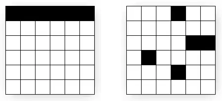

Bitmaps
In words: The 1st bitmap is described: A 6x6 grid with 6 pixels across the top row (nice and short); while the 2nd bitmap is described: A 6x6 grid with 6 pixels in positions (4,1), (5,3), (6,3), (2,4), (4,5) (much longer).
In computers: A compressed file (.gif) of the 1st bitmap is much smaller than that of the 2nd bitmap.
Both bitmaps are the same size, and contain the same number of pixels, so the total amount of uncompressed information in them is the same, as per conservation of information. However, the information can be losslessly compressed to a greater degree in the 1st bitmap, so the 2nd bitmap contains more compressed information. Correspondingly, with no (uncompressed) information loss, the 2nd bitmap's entropy is higher.
