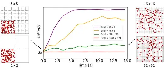

The answer of @Abhay Hegde is a good one. But I would like to complement his answer with an intuitive example. Let’s take a system of particles expanding in a room, initialised in the bottom left corner. As an observer, we can separate our room into different “boxes”, and then count the number of particle in each box. These boxed will give us a coarse grained representation of the system. Assuming that the highest entropy state would correspond to the case where all boxes contain an equal number of particle, we can compute the entropy as:
$$S = \sum N_i \log(N_i),$$ where $N_i$ is the number of particles in each box. Interrestingly, the computed entropy depends on the grid resolution used to define the boxes. As we increase the resolution, our knowledge of the system gradually increases, up to the point where we have perfect knowledge of all the microstates when the grid size is very small (128x128). In this situation, as the hidden information is always zero, the entropy stays constant. Thus, for a very high resolution, our knowledge about the system is no longer coarse-grained, but fine-grained. That's because there will never be more than one particle in the same box.
Coarse grained entropy evolution of particles spreading in a box interacting via Lennard-Jones potential. The entropy is calculated for different choices of grid resolution
