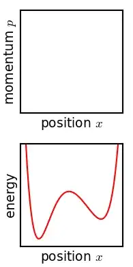

The intuitive interpretation of \ref{1} is that the probability density evolves in phase space like an incompressible fluid: it can stretch and deform, but its volume in phase space remains constant (figure below, from Wikipedia, shows a 1D example).

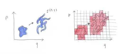

The solution proposed by Gibbs is that $\rho$ is actually coarse grained. This means that there is a maximum amount of "stretching" $\rho$ can undergo: if it is stretched further, the volume it takes in phase space will increase. I tried to sketch a 1D example below: on the left you have a "fine-grained" $\rho$, which follows equation \ref{1}, while on the right you have a coarse-grained $\rho$, which takes more phase space volume as it evolves in time.
The problem with the coarse grained entropy is that it is not clear what is the mechanism that should led to a coarse graining of $\rho$. It could be that phase space itself is quantized, as the Heisenberg uncertainty principle seems to suggest. Or it could be, as suggested by Jaynes (E.T. Jaynes; Gibbs vs Boltzmann Entropies; American Journal of Physics,391,1965), that blurring of entropy simply reflects our loss of knowledge about the system. Blurring can be the mechanism that connects the reversible microscopic dynamics to the irreversible macroscopic dynamics, but at the moment there is no consensus in the scientific community about the exact nature of the blurring mechanism.
