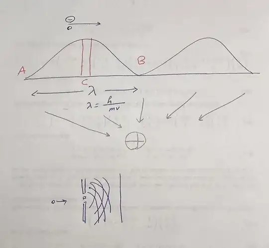

Assuming an electron is moving along a path with constant velocity. According to the square modulus of it’s wave function, it has lower probability to be present at points A and B and higher probability at point C. Then should we expect the average electric force induced by another charged particle be less effective in the areas that electron is less present than the peaks? In other words, in double slit experiment with a charged particle, should we expect stronger force interactions in the peaks compared to the valleys- where particle is less likely to be present?
PS: to avoid the second charged particle’s effect on the wave function, let’s assume the second particle appears instantaneously from vacuum or just shows up to the proximity from distance. Just to eliminate its effect on the test particle’s wave function.

I'll consider the question of the OP as it's formulated in a comment to annav's answer:
Even though the wave function is dictated by the potential, but it’s related probability still follows a sine shape over the length, with higher probability in some areas and lower in others. My main confusion is if that electron feels same average force/ potential over all those areas ?
For an electron with the simple Hamiltonian
$$\hat H=\frac{\hat p^2}{2m}+\hat U$$
we can define the acceleration operator as
$$\hat{\vec{a}}=-\frac{\hat{\nabla U}}m,$$
which is compatible with the Newtonian notions of force and acceleration (see a derivation here). Now we can try to find the average acceleration using the usual method of computation of the expectation value of an observable:
$$\langle \vec{a}\rangle=\langle\psi|\hat{\vec{a}}|\psi\rangle.$$
If you compute this in position representation, you'll find that it's just an integral of the acceleration at different points in space weighted by probability density:
$$\langle \vec{a}\rangle=\int_{\mathbb{R}^3}\vec a(\vec x)|\psi(\vec x)|^2\,\mathrm{d}V.$$
So yes, the wavefunction's magnitude does affect the contribution of acceleration at different points in space.
