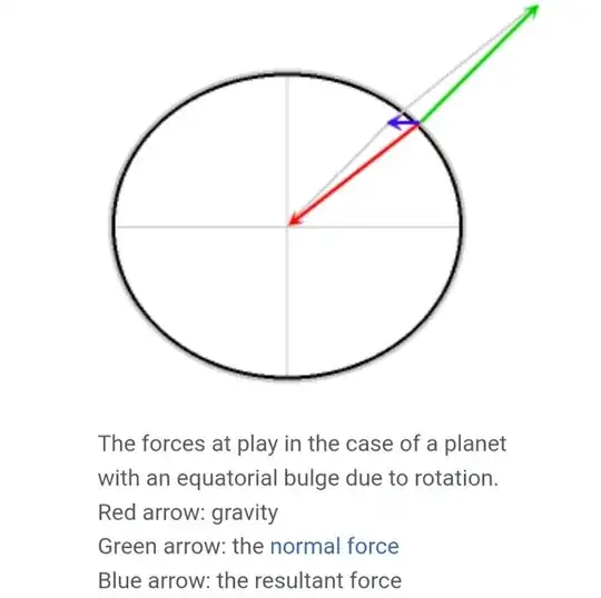

From there, I understood that the resultant of normal force (N) and gravity (mg) is the required centripetal force. But what is bothering me now is HOW? According to the answers, the normal force is slanted such that it is not exactly opposite to gravity. Thus, they don't cancel out, resulting in a horizontal centripetal force. I'm still confused and have the following questions :
  1. Why is normal force slanted in the first place ? (Is it because of the earth's bulge, friction or centrifugal force?)
  2. I think there's also a vertically-upwards component of the resultant, why is that? (the resultant of normal force and gravity)

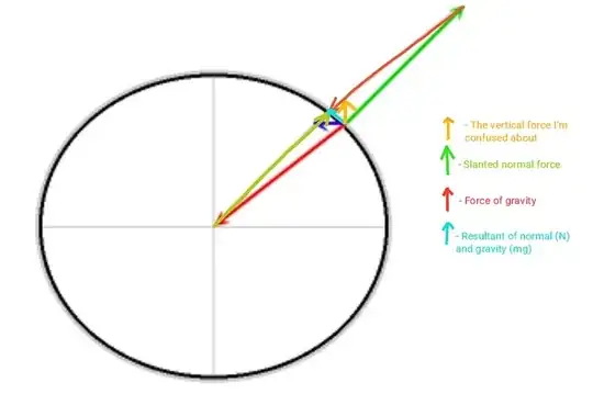

enter image description hereenter image description here This is what I see, what is the reason behind this?
Source of the image - https://en.wikipedia.org/wiki/Equatorial_bulge
Edit - I've gone through this question Is the normal force equal to weight if we take the rotation of Earth into account? but this doesn't clear my doubt regarding the upward component of the resultant of gravity and the normal force. I posted this question because I wanted some more insight into that poleward force and its relation to the bulge of the earth, which isn't emphasised in that question. kindly reopen my question.

If you are not on the equator, gravity and the reaction force don't add up to a force in the right direction to keep you moving in a circle around the axis. If you are moving in a circle, there must be another force. Perhaps you hold on to the surface. Looking at your diagram, what force do you need to make the total add up to the purple arrow?
The reaction force will adjust itself to keep you on the surface. Gravity pulls you onto the surface. The reaction keeps you from going beneath it. Gravity will be a little stronger. You need to pull yourself along the surface in the direction of the blue arrow. If you do, you will stay fixed to one spot on the Earth as it rotates. If you don't you will slide in the direction opposite the blue arrow.
That leaves the question of why the normal reaction force is not aligned with gravity. It has to do with the Earth's bulge.

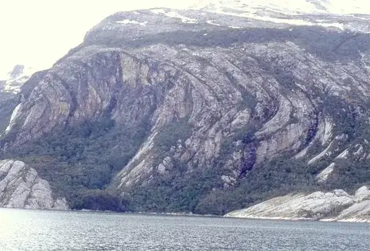

Earth is not perfectly rigid. The interior is liquid. The ocean is liquid. The crust is solid rock. But over millions of years, rock bends and flows as this example from Eastern Connecticut State University shows. See Structural Geology Photos - Folds
If you have water sitting where you are, it cannot hold on. It will flow toward the equator. Over time, so will rock. It will pile up. Lower latitudes will become fatter. The shape of the surface will change like the diagram shows. When the shape has changed enough that the tilted reaction forces provides needed blue component, there is no further pull toward the equator.

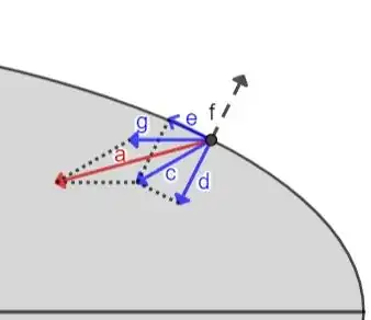

Again, the only real force is the force of gravity (a) acting towards the centre. (c) is the inward component normal to the surface that is felt as weight and (f) is the reaction force to (c). Component force (g) is not balanced and provides the inward centripetal acceleration. Since g is fully accounted for as providing the centripetal force, the only forces left are component (c) and reaction force (f). Since these are parallel and both normal to the surface, there is no longer any sideways force on surface particles. You can view the centripetal force simply as a component of the inward gravitational force. You could interpret the centrifugal force as the resultant of forces (a) and (f), but this is difficult to justify, as force (f) is cancelled by force (c). It also worth noting that the reaction force (f) is not really a 'tilted' normal. It is perpendicular or normal to the surface. It is only tilted in the sense that is not parallel to the inward acting gravity force (a). It is also worth noting that something like the Earth that has had millions of years to find equilibrium should be almost the perfect oblate shape required for equilibrium.
Food for thought: If you build a tall tower using a plumb bob to ensure it is vertical, will the tower be parallel to (f) or (a)?

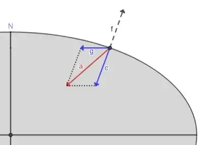

Edit: Decided to add this final free body diagram to illustrate the last point. It represents a zoomed in portion of an over oblate planetoid.
Diagram 4:
(a) is the centre pointing gravitational force. (g) is the component of (a) that provides the centripetal force. That leaves component(c) which is subdivided into two more components, (d) which is the downward normal force, which is balanced by the reaction normal force (f) and sideways force (e) which is not balanced and drives surface material towards the pole until the equilibrium oblate shape is achieved.
