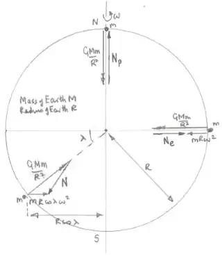

Here is a diagram of an ideal spherical Earth radius $R$, mass $M$ rotating at an angular speed $\omega$ with an object mass $m$ in contact with the surface of the Earth.
The object on the Earth is subject to two forces: gravitational attraction $\frac{GMm}{R^2}=mg$ where $g$ is the gravitational field strength and a reaction due to the Earth $N$.
The net force on the object produces the centripetal acceleration of the object.
At the poles there is no centripetal acceleration so $mg -N_{\rm pole} = m 0 \Rightarrow N_{\rm pole} = mg$ the equation that you quoted in your first sentence.
At the Equator the equation of motion is $mg - N_{\rm equator} = mR\omega^2$ so the normal reaction $N_{\rm equator}$ is smaller than the gravitational attraction $mg$.
At other points on the Earth the reaction $N$ is smaller than the gravitational attraction $mg$ but not by as much as at the equator but you will note that on a spherical Earth that reaction is no longer normal to the Earth's surface.

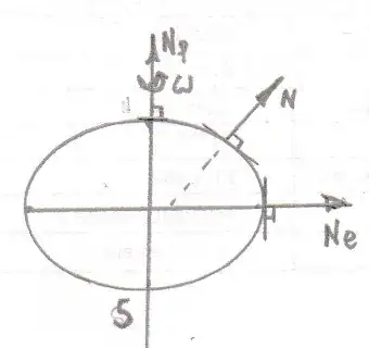

A better approximation to the shape of the Earth is that it is an oblate spheroid (like a squashed sphere) as shown greatly exaggerated below.
With the Earth being that shape the reaction force on the mass is normal to the surface and in general a plumb line does not point towards the centre of the Earth.
