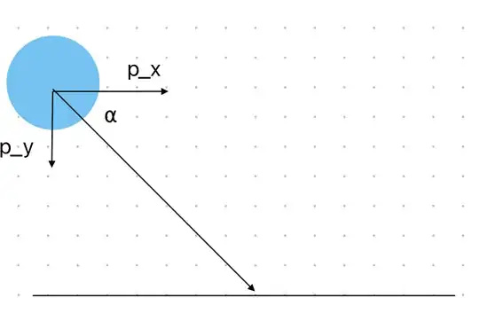

Okay, this is a very fun question for which we can test our knowledge of conservation laws. Here in your situation we can use the law of conservation of linear momentum.
To test it let's assume that the ball is moving with a velocity $\vec{v}$ making a angle of $\alpha$ with the horizontal then we can associate its momentum components as $$\begin{align} p_x & = mv \cos\alpha \\ p_y & = -mv \sin\alpha \end{align}$$
Reflection diagram What happens then is that the normal force will only act in the y-direction. Why?
I try to look at it from this perspective. Don't consider the ball to be moving at an angle. Imagine that the ball is going downways and going rightwards at the same time. Why do we say that? It is because both of the momentum or I should particularly say the velocities are independent of each other. So we can break down the motion in two different kinds of motion and what we do is to combine the two motions. So when we talk about the vertical case it is very obvious that the normal force is perpendicular to the surface. The second case shows us that the ball will not apply any kind of force on the surface so there is no normal force along the horizontal direction. And now we can apply conservation of momentum to say that it must reflect at the same angle with which it was incident.
