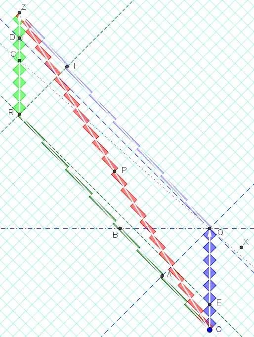

A spacetime diagram might help. I have drawn it on rotated graph paper to help us visualize the ticks better, and I have chosen speeds of (3/5)c for the travelers (instead of (1/2)c) so that we can more easily count on the rotated graph paper.
[It turns out that velocities with rational Doppler factors lead to easier arithmetic... (3/5)c has a Doppler factor of 2, whereas (1/2)c has a Doppler factor of $\sqrt{3}$. The relative speed of the outgoing twins turns out to be $(15/17)$, which has a Doppler factor of 4.]
With this spacetime diagram, one can tell a detailed story what each observer would measure... by visual observation of light signals, or assigning-coordinates-by-simultaneity, or both.
The bottom line is that: while the actual observations of the other traveler appear to be irregular because of their relative motions, they will be identical when they reunite and compare notes. Indeed, by your construction, their worldlines through spacetime are symmetrical.
I've located events that would be useful to describe what Bob [in BLUE] (the initially-forward traveler) would say about Carol [in GREEN] (the initially-backward traveler). Alice [in RED] is the inertial observer.

For example, Bob might watch what Carol does (because Carol will broadcast/stream her life).
  • From O to Q, Bob will see Carol move in slow motion... since in 8 years of Bob's clock, Bob only sees 2 years of Carol's life from O to A. (Follow the light signals along the grid.)
  • At Q, when Bob turns around, Bob will see Carol moving normally again... but delayed. During the first year after Q for Bob (the beginning of the ninth year after separation), Bob sees the start of Carol's third year after separation. In the six years from Q to F, Bob sees six years of Carol's life from A to R.
  • At R, when Carol turns around, Bob will see Carol moving at high speed. In the last two years from F to reunion at Z, Bob will see the last eight years of Carol from R to Z.
  • At the reunion event Z, Bob will have seen in his 16 years of travel, all 16 years of Carol... but in an irregular way.
    .. And Carol will say the same thing about Bob.
Of course, Alice will tell a different story of how she watched Bob's 16 years pass irregularly in her 20 years of waiting for the reunion. However, Alice's description of Carol will be identical to her description of Bob.
