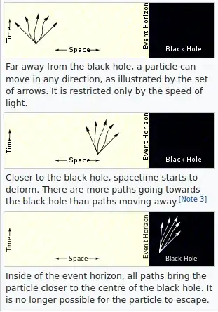

And, I include a screenshot of this Wikipedia link about the Event horizon of a black hole, which also illustrates this:
Wikipedia Figure 1

This is the "river" picture of black holes, as Dale said, but I disagree strongly with his statement that it is a "nice heuristic".
Rivers flow at a certain speed. If you fall into a river, friction with the water will accelerate you until you're moving at the same speed as the water.
Gravity doesn't work like that at all. Gravity doesn't give you a certain velocity, but a certain acceleration. The time reversal of a river is a river flowing in the opposite direction, but the time reversal of a gravitational field is a gravitational field in the same direction. If you film a ball being tossed in the air and play the film backward, the ball is still attracted toward the earth in the reversed film. Gravity is a conservative, not a dissipative, force. The river picture fails to capture any of those properties.
The river picture leads people to wonder why black holes don't just suck up everything around them, and how the space that flows into them is replenished. Those would be reasonable questions if the river picture made sense, but it just doesn't.
The river picture is inconsistently used only for black holes when it could equally be applied to any other gravitating body. Black holes are unique in that time symmetry is broken at the event horizon and inside it, but that's irrelevant to the observable behavior of astronomical black holes, which depends only on the physics outside the horizon. The physics outside is time-symmetric, and doesn't fundamentally differ from that of other gravitating bodies. The river picture tries to explain the broken time symmetry by breaking it everywhere, even outside the horizon. But it isn't broken outside the horizon. The explanation is wrong.
benrg
  • 29,129
27
This is referring to the so-called “river model” of spacetime. This model is explained in detail here:
“The river model of black holes” — at arXiv.org
In the river model space flows into the black hole and the motion of particles is affected by the flow of space. The event horizon is where the flow of space exceeds $c$.
The issue with the river model is that it does not generalize to arbitrary spacetimes. It does work for the Schwarzschild and the Kerr spacetimes, but not other spacetimes in general. So while it can be a nice heuristic it cannot be thought of as the way gravity works.
