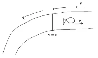

Perhaps a simpler way to see the same thing is the so called "river analogy" or "waterfall analogy". As you can see in the picture below, a river flows with speed $v$ which increases downwards. A salmon travels upstream with fixed speed $c$:
river analogy for black holes
In the region with $v < c$ (where the salmon is now in the picture) the salmon can do whatever it wants. There is a point where the speed of the river equals that of the salmon, $v=c$: if the salmon ends up there it will get stuck and be unable to move. If it ends up in the region $v>c$ there's nothing it can do to avoid being dragged downwards.
In this analogy the salmon is a photon, the point $v=c$ is the event horizon and the lower region where $v>c$ is the inside of the black hole. In fact if the salmon is stuck at $v=c$ and you happen to be travelling towards it, in your reference frame you'll see the salmon coming towards you at speed $c$. This is exactly what happens in a black hole.
The intuitive reason why this happens is that the universe has a speed limit, which is the speed of light. In fact if the salmon was capable of accelerating to higher speeds it could free itself from $v=c$; and another salmon travelling at $c' > c$ would see a different event horizon at $v=c'$, but $v=c$ would not be a special surface for it. The event horizon is the same for everyone because no one can go faster than light. In fact in a purely Newtonian universe (in which there is no speed limit) there are no black holes in this sense: light rays could come out of the black hole, but then they'd have to turn around and fall back in. This is impossible in relativistic black holes and impossible in the river analogy. In a newtonian black hole you could in principle jump out, then start accelerating and free yourself.
