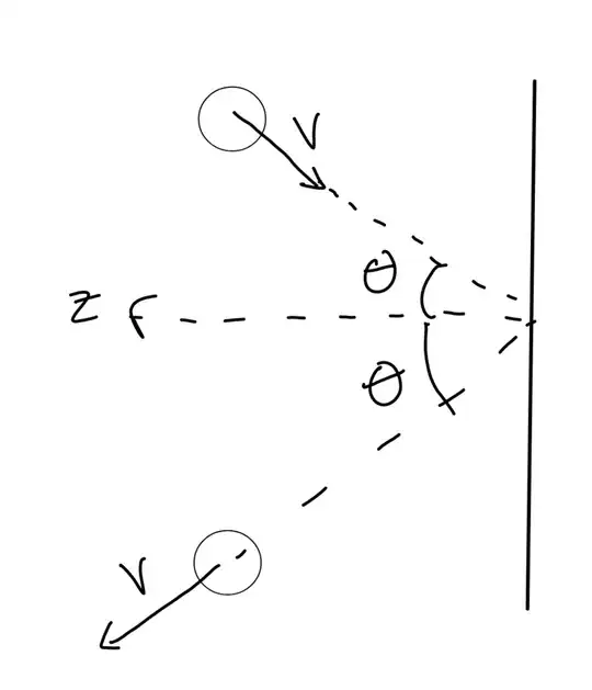

We start off by considering a ball bouncing from a wall. This is illustrated by figure below:
Note that the momentum of the ball is changed only in z direction by an amount $\Delta p = 2mvcos(\theta)$ where $v$ is the speed of the ball. This type of collisions will happen many time.
Now consider a small time interval $\delta t$. The force, $dF$ imparted to the wall will be equal to the rate of collisions and change in momentum of the particles due to these collisions. Therefore we can write:
$dF = \Delta p \frac{\delta N}{\delta t} = 2mvcos(\theta)\frac{\delta N}{\delta t}$.

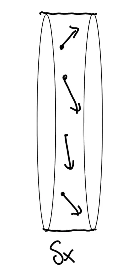

$\delta N$ signifies the number of collisions during that time interval. Using figure below, we can find the number of collisions.
As shown in the figure above, all the particles inside that small volume will collide with the wall. We can then write
$\delta N = n \delta V = nA \delta x $
Now, we note that that region is created due to the velocity of the particles. Hence, we expect $\delta x = v \delta t$. However, there is something missing. We have a continuous range of velocities. To incorporate this fact, we add the probability to find a particle in that speed (given by $f(\vec{v})d^3\vec{v}$) into the expression. Putting all of this together, we have
$dF = 2mvcos(\theta)\frac{nA v f(\vec{v})d^3\vec{v}\delta t }{\delta t} = 2mnAv^2cos(\theta) f(\vec{v})d^3\vec{v} $
