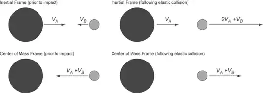

Pulling the piston does work on the particles. If we consider the pressure of gas as a result of particles hitting the container and being reflected back, then being scattered from a moving piston means that they scatter back with a higher or lower velocity (depending on whether the gas is being compressed or expanding.)
After some energy has been transferred to the gas, it comes to equilibrium via inter-molecular/atomic collisions (although in case of a quasistatic process, the process is so slow that gas always remains in equilibrium.)
The following might be a good image for illustrating the collision between a molecule (B) and a much heavier piston (A):
enter image description here (image source)
