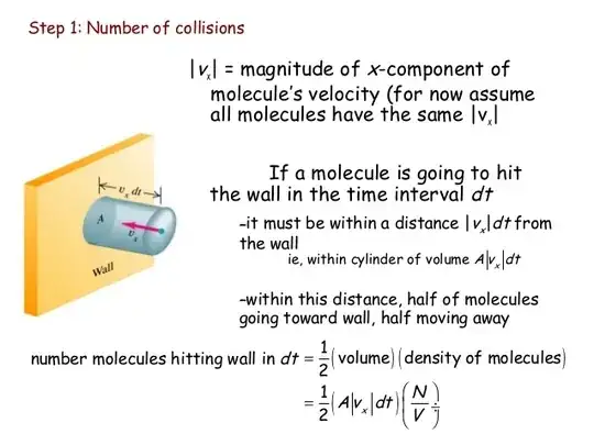

How many of the molecules will collide within a given area A of the wall normal to the x-direction in some fixed time interval Δt ? On average half the molecules have a positive x-component of velocity. Therefore half the molecules contained inside a cylindrical volume of cross sectional area A and length vΔt will strike the wall within a given area A during the time interval Δt.
So, the number of collision with A during $\Delta{t}$ is
$\frac{1}{2}\frac{NAv_x\Delta{t}}{V}$
So my question is how can we assume that half of the molecules are moving one way and half the other? I know that we are focusing on one co-ordinate i.e. x-coordinate, thus, we are not focusing in other directions like up and down etc. Nevertheless,I wondered, if I were the physicist coming up with this derivation, why would I divide the number of collisions by 2 saying that half of the particles go one way and half the other way. How can it be just half not one third any other probability.
