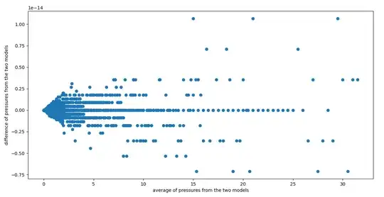

Labeling the particles should have no effect on the pressure. However, when we take the same measurement of pressure (for same $n$ and $N$) for the cases of labeled and unlabeled particles, we find that the pressure values actually differ. Since $\langle p \rangle (n,-N)$ is a monotonically increasing function, we may also plot the differences of pressure for labeling and not labeling the particles against the pressure measurements arranged according to the average values of the pressures obtained from the two models:
difference in pressure values on labeling and not labeling arranged according to pressure
Note: Though the fluctuations are very small $(\approx 1e{-13}\%)$, it seems that the pressure difference fluctuates more (around zero) when the values of pressure are higher. It may just be numerical error, but, as far as I know, python values are reliable upto $1e{-16}$.

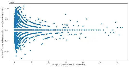

If we plot this ratio of the difference and average of pressures from the two models, the graph undeniably shows regular patterns:
plot of the ratio difference and average of pressures from the two models arranged according to pressure
Note: This is a function of the type $z = 2\dfrac{x-y}{x+y}$

You are being inconsistent with indistinguishability. If your $n$ particles are considered indistinguishable, then there are not $(N+1)^n$ possible configurations; this is instead the number of configurations of labelled particles. E.g. for two positions and two particles ($N=1,n=2$), the labelled configurations are "both on 0", "$1\mapsto0,2\mapsto1$", "$1\mapsto1,2\mapsto0$", and "both on 1," for $(1+1)^2=4$ configurations, but the unlabelled configurations are "both on 0", "different positions", and "both on 1," for only 3 configurations.
Dealing with unlabelled particles is an unnecessary complication. Just deal with distinguishable ones. Then your error is that the numerator in $$\langle p\rangle=\frac{\sum_jj\cdot N^{n-j}}{(N+1)^n}$$ is wrong. $N^{n-j}$ only counts how many ways you can distribute the "non-bunched" particles among the $N$ remaining positions. You also have the freedom to choose which $j$ particles are bunched $(\binom nj$). The corrected expression $$\langle p\rangle=\frac{\sum_jj\cdot\binom njN^{n-j}}{(N+1)^n}$$ produces a more reasonable graph.
