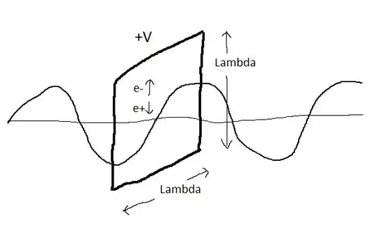

Imagine we have two parallel wires with a potential difference of $V$ volts that form the opposite sides of a square of size $\lambda$.
pic
Any virtual electron-positron pairs that form between the wires pick up an acceleration $a$ given by
$$a\sim\frac{eV}{m_e\lambda}.\tag{1}$$
