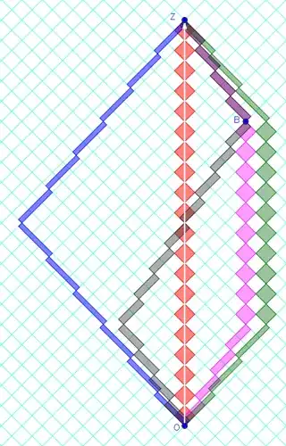

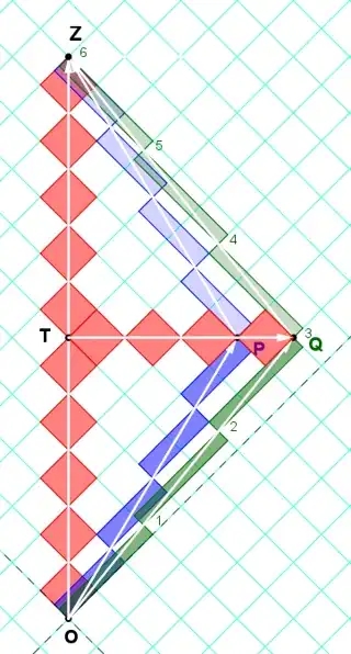

Building on @JohnRennie 's answer, here the visualization
(a "position-vs-time graph" or "spacetime diagram") of the calculation
for three clocks traveling at constant speed (constant-velocity for half the trip, then the oppositely-directed constant-velocity for the remaining half of the trip):
$|\vec v_{Alice}|=0c$, $\qquad$ $|\vec v_{Bob}|=(3/5)c$, $\qquad$ and $\qquad$ $|\vec v_{Carol}|=(4/5)c$,
with corresponding
$\gamma_{Alice}=1$, $\qquad$ $\gamma_{Bob}=(5/4)$, $\qquad$ and $\qquad$ $\gamma_{Carol}=(5/3)$.
These speeds are chosen for mathematical convenience (since their Doppler factors are rational [here: 1,2, and 3], we end up with Minkowski-triangles associated with Pythagorean Triples, leading to calculations with fractions).
So, the clocks that were synchronized at event O arrive unsynchronized at event Z.
By counting the "light-clock diamonds" (equal-area parallelograms, formed by the light-signals in their standard-issue light-clocks), we see that Alice's clock elapses 10 ticks, Bob's 8 ticks, and Carol's 6 ticks.
RRGP-robphy-AliceBobCarol
These various elapsed times ("the wristwatch 'proper times' along a worldline) are due to the fact that these are along different worldlines from O to Z, akin to @WillO 's comment about the odometers.
