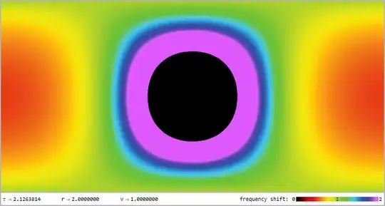

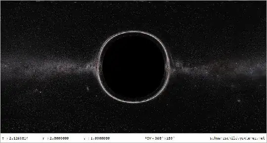

Alfred asked: "What is the frequency of the light seen by an observer free-falling into a black hole?"
The equations are already given in the answer above, but since an image says more than a thousand words here's the $360° \times 180°$ full panorama:
Schwarzschild Background
Schwarzschild Redshift Blueshift
That is the frequency shift of the background sky in the frame of an observer crossing the horizon with the negative escape velocity, i.e the speed of light.
The gravitational and kinematic time dilation cancel in the frame of the free faller (therefore $g^{\rm t t}=1$ in Raindrop coordinates) and the pure Doppler remains.
In the back the redshift of light emitted by the stars far away from the black hole is $\rm f_{obs}/f_0=1/2$, and in the front the blueshift would be infinite if it wasn't obscured by the shadow of the black hole.
If you look $90°$ to the side, $\rm f_{obs}/f_0=1$ since the transverse Doppler with a cancelled time dilation vanishes.
With rotating and/or charged black holes the picture is a little bit more complicated and when you cross the inner Cauchy horizon you can indeed receive an infinite blueshift which is not obscured by the shadow, but the $\rm f_{obs}/f_0=1$ perpendicular to the direction of motion is always the case for a free faller from rest at infinity.
