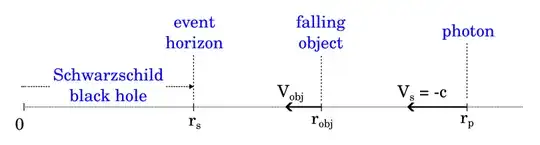

The problem is 1-D: there is an object in position $r_\text{obj}$ falling into a Schwarzschild black hole with velocity $V_\text{obj}$, followed by a light signal at position $r_p$. Diagram below:
Object falling into a black hole followed by a photon
Considering you know all the variables of the problem, how do you calculate if the object will ever receive the light signal before reaching the center of the BH?
I have the gut felling that the object will always receive it before reaching the event horizon, but I would like to know what the math says.

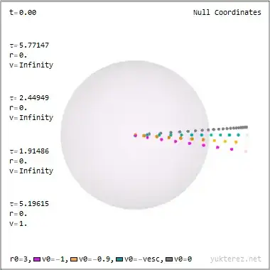

The photon doesn't always reach the falling object. In the classic Schwarzschild coordinates both's $\rm r$ converge to $\rm r\to 2$ (in natural units) at $\rm t \to \infty$, but they are always at least an infinitesimal $\rm \Delta r$ apart from each other if the initial distance was too large, and the $\rm \Delta t$ is undefined since $\rm \infty \pm \Delta t=\infty$. You can better see it in Raindrop or Finkelstein coordinates.
Here the photons are pink while the other colors are for free falling particles with different initial velocities; for example, the yellow particle at $\rm r=2$ never gets overtaken by the last photon entering the frame at $\rm r=3$:
Ivella wrote: "I have the gut felling that the object will always receive it before reaching the event horizon, but I would like to know what the math says."
In Finkelstein coordinates the coordinate velocity for an ingoing photon is $\rm dr/d\bar{t}=-1$ and for a free faller from infinity $\rm dr/d\bar{t}=\sqrt{2} \ (r-2)/(\sqrt{8}-r^{3/2})$.
In Raindrop coordinates we have $\rm dr/d\acute{t}=-1-\sqrt{2/r} \ $ for the photon and $\rm dr/d\acute{t}=-\sqrt{2/r} \ $ for the free faller.
If you integrate that to get the $\rm r(t)$ or $\rm t(r)$ you see some photons never catch up with some free fallers (see here for photons, here for free fallers and here for an overview, related topics are here and here).
