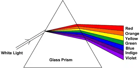

It is well known that a prism can "split light" by separating different frequencies of light:
prism diagram
Many sources state that the reason this happens is that the index of refraction is different for different frequencies. This is known as dispersion.
My question is about why dispersion exists. Is frequency dependence for refraction a property fundamental to all waves? Is the effect the result of some sort of non-linearity in response by the refracting material to electromagnetic fields? Are there (theoretically) any materials that have an essentially constant, non-unity index of refraction (at least for the visible spectrum)?

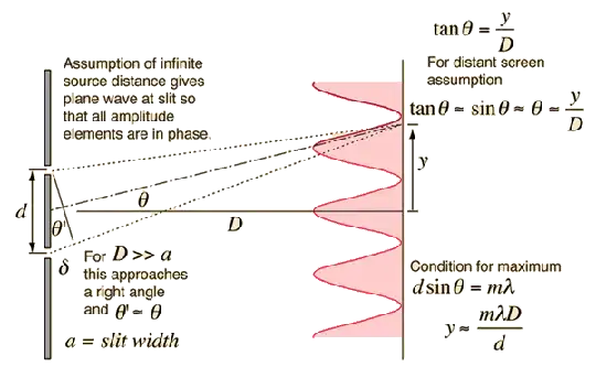

I will hand wave here, looking at the problem a photon at a time.
We know from the double slit experiment that even individual photons impinging on the double slit geometry display an interference pattern, characteristic of the frequency/energy of the photon and the geometry of the slits.
