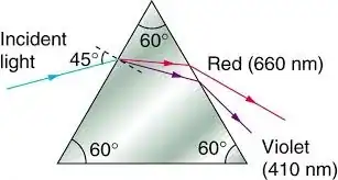

This phenomenon is due to the simple concept of refraction. Due to the difference in the wavelengths of each component of white light, this dispersion of white light occurs in denser/viscous media.
Snell's law states that, $$sin(i)/sin(r) = n2/n1 = v1/v2$$ where i is the angle of incidence and r is the angle of refraction, n1 and n2 are the refractive indices of media 1 and 2 respectively.
We also know that $v = f*y$, where f is the frequency of light and y is the wavelength. Hence, the angle of deviation depends on wavelength.
This is also the reason for the "spreading out" of light by a raindrop thus leading to the formation of rainbow.
In the image given above, the red and violet components of white light have different wavelengths and hence the angle of refraction differs significantly in the viscous media.
