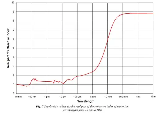

Electromagnetic radiation in a medium propagates according to the law $$ \mathbf E,\mathbf B \propto e^{\imath(\pm k_xx-\omega t)} $$ where $$ k_x^2 = \frac{n^2\omega^2}{c^2}\;. $$ The refractive index $n$ can also be complex, in which case its imaginary part describes the absorption of the EM wave in the medium. But the oscillating part is in any case $$ \propto e^{\imath ({\cal Re}\; n) x/ c} $$ where ${\cal Re}\; n$ is the real part of the refractive index. Thus the apparent speed of the EM is $$ c_{app} = \frac{c}{{\cal Re}\; n} $$ A diagram for the real part of the refractive index (online you can see it here) is the following:
(Optical) light has wavelengths in the range $400-700\;nm$, while microwaves have wavelengths in the range $1\; mm-1\: m$. From the diagram we see the $n$ is much smaller at ptical than micro wavelengths, thus optical EM waves travel faster than microwave EMs in water.
EDIT:
The above of course is about phase velocity. If you are interested in group velocity instead, $$ v_g = \frac{\partial \omega}{\partial k} $$ it can easily be checked from the same diagram that the same conclusion still applies.
