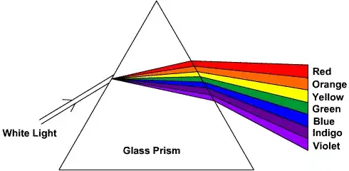

Now there is a classical and a QM explanation both for dispersion/refraction of EM waves/photons through a prizm.
In optics, dispersion is the phenomenon in which the phase velocity of a wave depends on its frequency.n optics, one important and familiar consequence of dispersion is the change in the angle of refraction of different colors of light,2 as seen in the spectrum produced by a dispersive prism and in chromatic aberration of lenses.The most familiar example of dispersion is probably a rainbow, in which dispersion causes the spatial separation of a white light into components of different wavelengths (different colors).
https://en.wikipedia.org/wiki/Dispersion_(optics)
Now even in the classical explanation of EM waves', it is easily explainable why the wavelength of different EM waves creates the dispersion we see in a prizm.

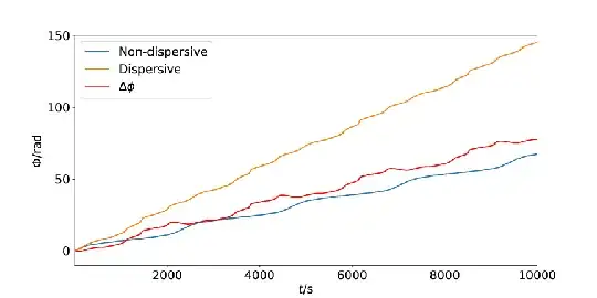

The phase of gravitational waves in the dispersive case and non-dispersive case and dephasing between two waveforms. The total Mass M=106 M⊙, the symmetric mass ratio ν=10−5, e=0.5, p=12M and a=0.9. We set DL=1.00 Gpc, where Z≈0.20 and D≈0.83 Gpc. The Compton wavelength of graviton λg=1.6×1013 km. The cyan, orange and red curves represent the non-dispersive's, dispersion's phase and dephasing respectively.

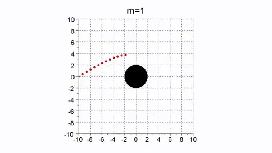

It is also known that light can move in non-straight paths on curved geometries of space-time. For example light can make a full circle around a black hole in what is known as the photon sphere. And it is also known that there are even solutions where a light ray can come back to the emmiting source after circling the black hole.
So, the surroundings of a black hole can act like a mirror (you can see yourself). The same goes for gravitational waves, they get diffracted so much that could go back to where it came. Thus black holes are mirrors for larger gravitational waves, just a very complicated mirror with a weird distorted image of yourself. By the way, the animation comes from a series of videos done by Viascience (highly recommended).
