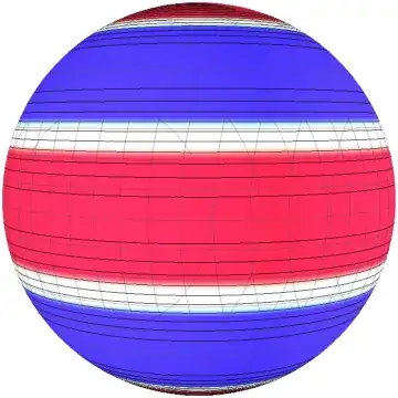

  • $m=0$, $\sigma \propto \left(3(x^2+y^2)^2-24(x^2+y^2)z^2+8z^4\right)/r^4$
    Mathematica graphics
    (which you can emulate with five charges of the appropriate magnitudes on a line),

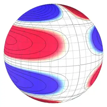

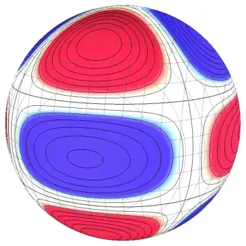

  • $m=1$, $\sigma \propto xz\left(3(x^2+y^2)-4z^2\right)/r^4$
    (which you can emulate with two lines of four charges),

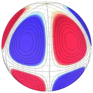

  • $m=2$, $\sigma \propto (x^2-y^2)(x^2+y^2-6z^2)/r^4$
    (which you can emulate with three coplanar squares),

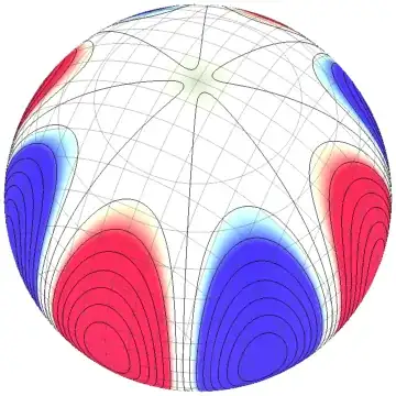

  • $m=3$, $\sigma \propto \operatorname{Re}\left[(x+iy)^3z\right]/r^4$
    (which you can emulate with two hexagons with alternating charges), and
  • $m=4$, $\sigma \propto \operatorname{Re}\left[(x+iy)^4\right]/r^4$
    (which you can emulate with an octagon).
