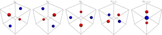

These can be modelled by suitable combinations of point charges as follows:
  • $Q_{2,xz}$ is produced by two point charges $+q$ at $(\pm d,0,\pm d)$ and two opposite point charges $-q$ at $(\pm d,0,\mp d)$, respectively;
  • $Q_{2,yz}$ is produced by two point charges $+q$ at $(0,\pm d,\pm d)$ and two opposite point charges $-q$ at $(0,\pm d,\mp d)$, respectively;
  • $Q_{2,xy}$ is produced by two point charges $+q$ at $(\pm d,\pm d,0)$ and two opposite point charges $-q$ at $(\pm d,0,\mp d)$, respectively;
  • $Q_{2,x^2-y^2}$ is produced by two point charges $+q$ at $(\pm d,0,0)$ and two opposite point charges $-q$ at $(0,\pm d,0)$, respectively; and finally
  • $Q_{2,0}$ is produced by two point charges $+q$ at $(0,0,\pm d)$ and a single point charge $-2q$ at the origin.
In all cases, you obtain the point quadrupole by taking the limit of $d\to0$ while making the charge $q\to\infty$ by keeping $qd^2$ constant.
Given any quadrupole moment, you can find the corresponding point quadrupole by choosing an appropriate linear combination of the five fields described above. However, this is a slightly misleading statement, because this scheme asks you to put a bunch of charges around (as many as 19) and this is not a minimal number. To get that minimal number, you need to use the cartesian form of the tensor, which has components \begin{align} Q_{ij} & = \int (x_ix_j -\frac13 \delta_{ij}r^2)\rho(\mathbf r)\mathrm d\mathbf r, \end{align} and which describes a traceless, symmetric, rank-two tensor (a.k.a. a matrix). The cool thing about this formulation is that all such matrices can be diagonalized, so that there exists a frame of reference where only the $Q_{ii}$ are nonzero. This means, in turn, that there will always exist a point-charge model of the following form:
  • Two point charges $q_1$ at $\pm d \hat{\mathbf e}_1$, for some unit vector $\hat{\mathbf e}_1$, two point charges $q_2$ at $\pm d \hat{\mathbf e}_2$, for some unit vector $\hat{\mathbf e}_2$ orthogonal to $\hat{\mathbf e}_1$, two point charges $q_3$ at $\pm d \hat{\mathbf e}_3$, for some unit vector $\hat{\mathbf e}_3$ orthogonal to both $\hat{\mathbf e}_1$ and $\hat{\mathbf e}_2$, and a single point charge $-2(q_1+q_2+q_3)$ at the origin.
