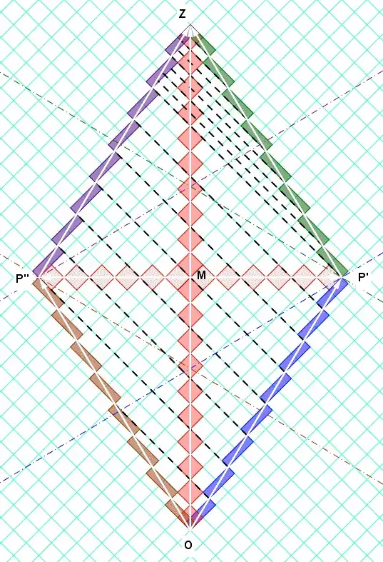

A spacetime diagram on rotated graph paper allows ticks to be read off.
Essentially, follow the bouncing light-signals (arranged so that the principle of relativity is satisfied), which bounce off parallel mirror worldlines [not shown].
All light-clock diamonds (which visualize the ticks of a wristwatch) have the same area.
Here is one for the problem you pose.
The light rays broadcast by the initially-forward-traveler are shown, which can be used to compare what the other observers see with their eyes to compare the remote clock-face with the local clock-face (associated with the Doppler effect).
The most time elapses on the inertial path from separation to reunion.
robphy-RRGP-triplet
This diagram is taken from my earlier answer https://physics.stackexchange.com/a/402711/148184 from What if two twins flew off in opposite directions and were reunited in a perfectly symmetric way, would they have aged same?
A more elaborate explanation is at another answer https://physics.stackexchange.com/a/434193/148184 from Question about Special Relativity similar to twin clock experiment
