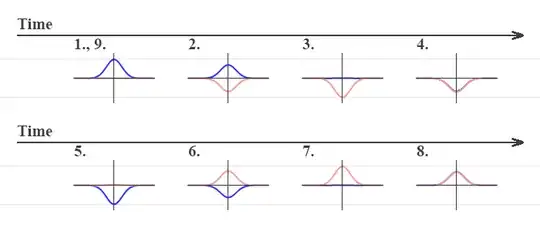

Here're key-frames from a time evolution of a quantum harmonic oscillator in it's ground state (source): enter image description here
So, I do understand that such a state may equally well describe grand variety of systems, but for now I want to focus on just 1 "particle on a spring" example, just to see if the following description will be all on itself valid:
Time Particle's position Particle's momentum (direction only)
$1., 9.$ $x_0$ (equilibrium point) $x_1$ (maximum stretching)
$3.$ $x_1$ $x_{-1}$ (maximum compression)
$5.$ $x_0$ $x_{-1}$
$7.$ $x_{-1}$ $x_1$
Btw, I do understand also that:
  • these $x$ points are arbitrary: we could've started at any other point than $x_0$ (with it's role as "equilibrium point" unchanged), and $x_1$ and $x_{-1}$ roles might've been swapped.
  • measuring upon the system in the table would not have revealed a "particle" in it's $x$ position (with described momentum), but rather in any of possible outcomes.
I'm just interested in validity of meaning I've put in that table - say, as a time evolution of just 1 eigenstate.
In quantum mechanics, particles do not have well-defined positions or momenta. Instead, we can only talk about the probability distribution we would get if we measured them. These probability distributions are given by the Born rule, which says that the squared norm of the wavefunction (expressed in the basis of the variable being measured) is the probability density function for the measurement of that variable. For example, the probability of measuring the position to be in some interval $[a,b]$ is given by $\int_a^b\mathrm{d}x\,\lvert\psi(x)\rvert^2$.
When a state is an eigenstate of the Hamiltonian, such as the ground state, it is called a stationary state. This is because its time evolution is entirely given by a phase factor: $\psi(x,t)=e^{-iEt/\hbar}\psi(x,0)$, where $\psi(x,0)$ is an eigenfunction with energy eigenvalue $E$. Notably, when you take the squared norm, the time dependence vanishes, since $\lvert e^{-iEt/\hbar}\rvert^2=1$, meaning the probability distributions for measurements are the same at any time. Therefore, it does not make sense to think of a particle in a quantum harmonic oscillator as moving back and forth, analogous to a classical harmonic oscillator. In particular, the particle effectively does not change if it is in an energy eigenstate. However, if the particle is not in an energy eigenstate (instead being in a superposition of states with different energies), then the expectation values of the position and momentum will oscillate similar to the classical case.
