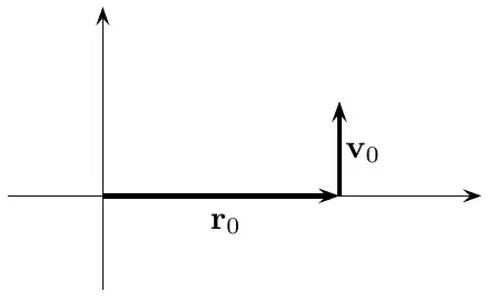

Suppose to have in the origin of axes the Sun, and consider a planet, with negligible mass, with initial position and speed like in this figure:

Write in this way the solution of the DE we obtained $$ w = A \cos \left[ q (\theta - B) \right] $$ where $A$ and $B$ are arbitrary constants. Doing backwards sobstitutions we done ($u=w+\frac{1}{p}$ and $r=\frac{1}{u}$) we get $$ r = \frac{p}{1+e \cos \left[ q (\theta - B) \right]} $$ where we called $e$ the $Ap$ constant. Imposing the initial condition of the figure ($\mathbf{r}_0 = r_0 \hat{\mathbf{x}} $ and $ \mathbf{v}_0 = v_0 \hat{\mathbf{y}}$), implies that at $t=0$ ($\Rightarrow$ the starting $ \theta = 0$) we have $\frac{dr}{d\theta} = 0$ (we can simply put $B=0$) and $r=r_0$ (so $e=\frac{p}{r_0}-1$) $$ r (\theta) = r_0 \frac{ \frac{p}{r_0} }{1 + \left( \frac{p}{r_0} -1 \right) \cos (q \theta)} $$ where (to connect $p$ and $q$ to initial value, we exploited the fact that at $t=0$ angular momentum is $L=\gamma_0 m r_0 v_0$, while energy is $E = \gamma_0 mc^2 - \frac{\alpha m}{r_0}$: we only have to substitute this constants $E$ and $L$ into $q$ and $p$ previously written) $$ q = \sqrt{1-\frac{\alpha^2 (c^2 - v_0^2)}{c^4 r_0^2 v_0^2}} $$ and $$ p = \frac{ \frac{r_0^2 v_0^2 c^4}{c^2 - v_0^2} - \alpha^2 }{ \alpha \left( \frac{c^3}{\sqrt{c^2 - v_0^2}} - \frac{\alpha}{r_0} \right) } $$
