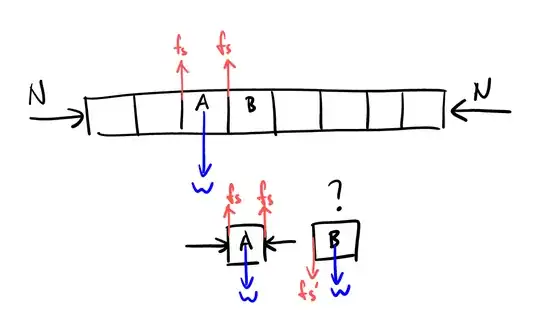

Considering a rack of blocks, and that I am able to hold it up in a horizontal line without it collapsing.
I am trying to draw the free body diagram of one of the blocks in the middle portion, block A.
I would draw two Normal contact forces from the sides, the weight, and two static frictions from the adjacent blocks. Naturally this explains why A is in equilibrium.
However, I get confused when I draw the free body diagram for the adjacent blocks, knowing that there must be an Action Reaction pair of the static friction. (Static friction by B on A = - Static friction by A on B), and this AR of static friction points downwards on B.
Am I getting something wrong here?

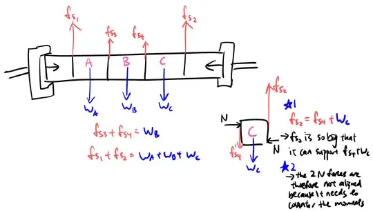

Yes there is an upward force on $A$ due to $B$ and an equal and opposite reaction force on $B$ due to $A$ but then there is a larger upward force on $B$ due to $C$ and the corresponding reaction force on $C$ and then an even larger upward force on $C$ due to $D$ etc . . . with the largest upward forces being applied externally at the outer ends of the line of blocks.
As you move away from the centre the upward frictional force must increase because that force is "holding up" all those blocks which are closer to the centre. In the diagram the Newton third law pairs of forces are bracketed.
Each block has a net upward force equal to its weight.

Then there is a larger upward force on B due to C " But shouldnt the upward force on B due to C and due to A be the same ? Since, we know that B is at rest, so lateral force on B due to A should be same as lateral force on B due to C. And if lateral forces are the same, the friction forces should be the same as well.
The answer to this question is that when normal reactions are same maximum limiting value of friction will be same but it may happen that for inner blocks friction is less than this maximimum limiting force while for outer blocks it is equal to the maximum limiting force.

Static friction can exert any force on a body within the maximum given by the coefficient of friction, and the actual force is just the amount needed to keep the body motionless.
Think of a body on a (non-slippery) surface slightly inclined to the right, e.g. by 5 degrees. It surely gets less than the maximum static friction force, otherwise friction to the left would be greater than the gravitational component to the right, and the block would start moving to the left, which doesn't happen.
It's correct that, in your setting, the lateral forces onto a block from the left and right are equal, but that doesn't imply identical left and right friction forces, only identical friction force limits.

Thank you Farcher for that little hint!
I think my answer is: when we look at A+B+C, the static frictions fs1+fs2 must balance all 3 weights!
But when we look at object B itself, fs3 and fs4 is smaller! (in this case fs3+fs4 is 1/3 that of fs1+fs2)
Then when we look at Object C, there's a fs4' pointing down and there's the fs2 pointing up. fs2 is large enough to balance the downwards fs4'+Wc.
But this also means that the N forces on both sides of C will be different, and not aligned, because we still have to consider balancing rotational moments (caused by the anticlockwise moments of fs4' and fs2).
I hope this is right now!
