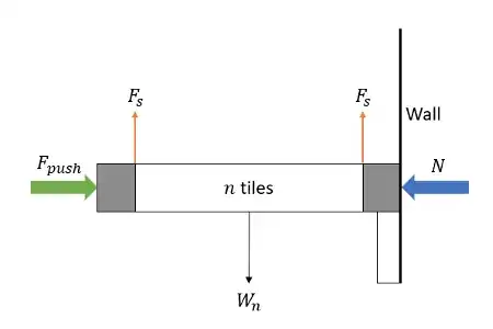

In my study, I attempted to combine the coefficient of static friction equation and an equation I derived by myself. 2F=W(number of tiles).

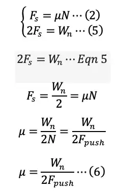

Derivation of alternative COF formula

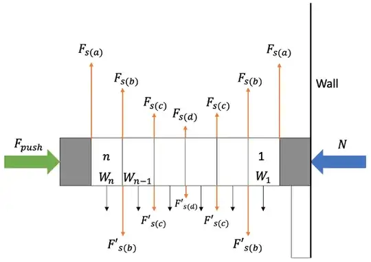

However, this seems to only work for the case in which there is one tile in the middle since there will be action-reaction pairs produced by the frictional forces if more tiles are involved as shown below. What should I do?
