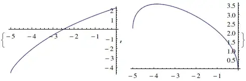

$\color{green}{\textrm{Numerics}}$: For the $W_p=5.$ and $d=1.$ Plot of transcendental equation (Last two equations of OP) for even and odd solutions as a function of $W$ are as,
$\color{green}{\textrm{Which gives "ONE" bound states. }}$
and, $N \approx 0.712$
Note: In general (after so- many calculations) we found a rule: the Total number of bound states for a square potential well are given as $[N]+1$, where [.] denotes the integer part} Reference.
$\color{green}{\textrm{Hence, $N$ gives "One" bound states.}}$
I have the used: $\hbar=1, 2m=1$
